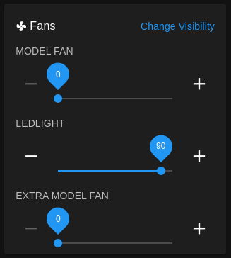

; LED Lights
M950 F3 C"out0" Q5000
M106 P3 C"LEDLIGHT" S0.9 H-1
