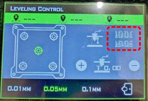

- Added 4-point bilinear leveling function.
- Increase the leveling manual detection function.
